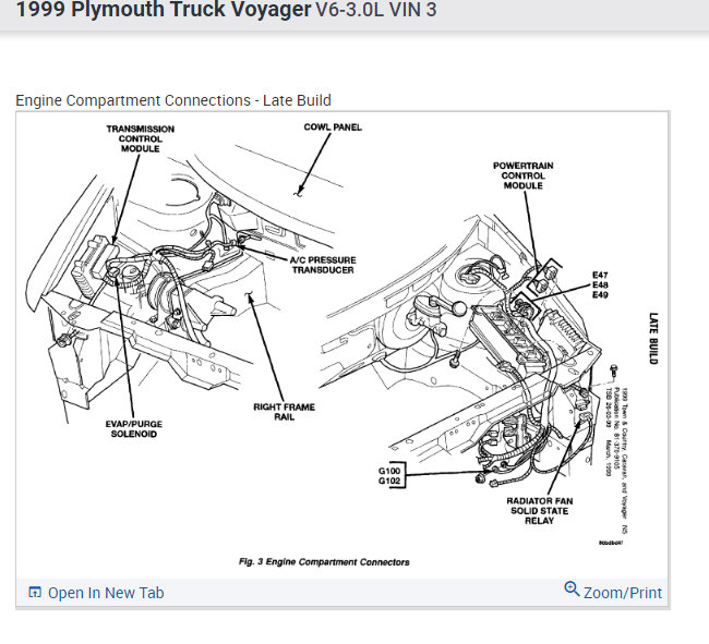

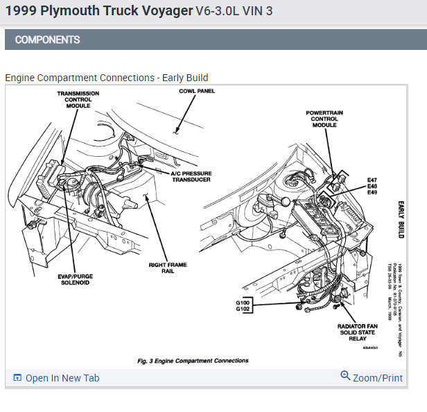

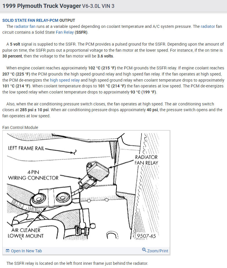

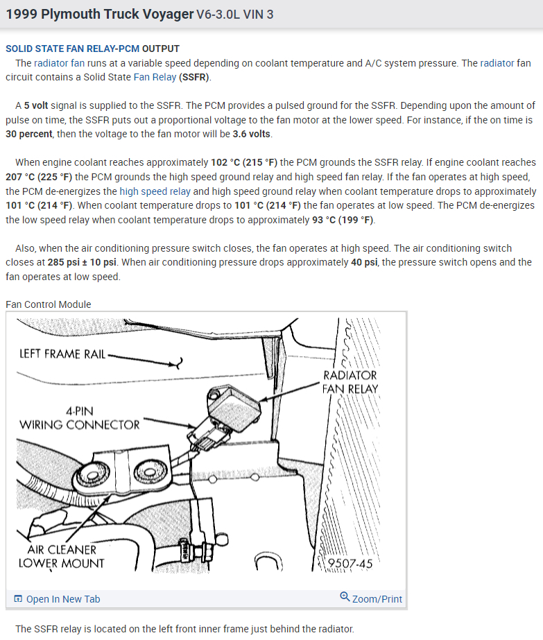

I need to find the cooling fan relay to check it. My fans are good the fuse is good. the book shows we have one but nothing is labeled can you tell me which relay it is and where it is located. We replaced the thermostat and the sensor but that still did not kick the fans on and as a result the car overheats. Help please.
Aug 19, 2009 at 10:10 PM
SQM
  • 6,383 POSTS

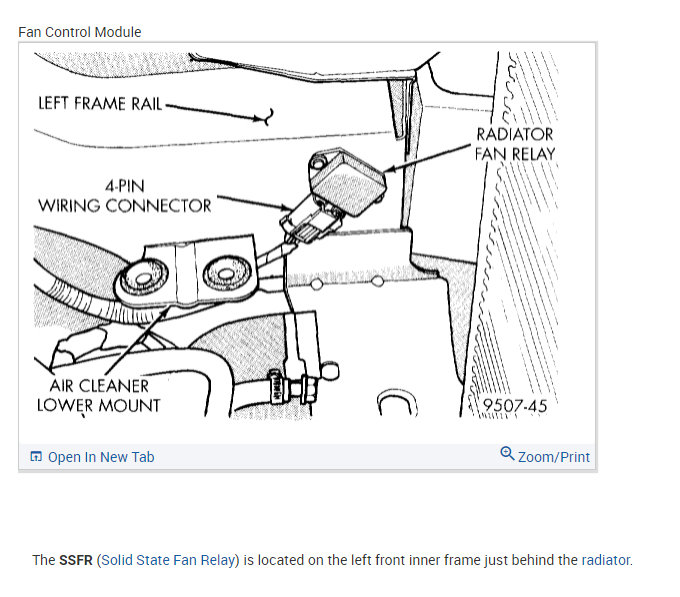

The cooling fan relay, also know as Solid state fan relay (SSFR), is located on the left front inner frame, behind the radiator (see diagram below)
Here is a helpful guide of how to test relays:

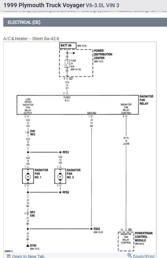

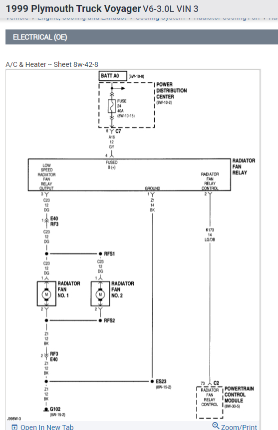

I have included the wiring schematics for the fan as well.
