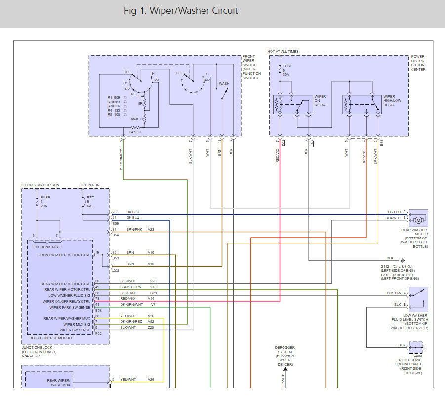

My problem is the front windshield wipers will not work. I have checked fuse under dash and in fuse/relay block under hood; both okay. Replaced multi-switch: wiper, washer, bright lights, turn signal. Replaced both relays under hood. At the wiring connector for the wipers under hood I am able to get wipers to run by jumping from the positive battery post to the brown wire with white stripe

Help! This is what i have done so far and what is going on. I had a problem first with the instrument panel going out. i changed panel and nothing then changed BCM and bingo working panel, but now wipers do not work. i checked all fuses there okay. checked relays there okay. no power to the wiper motor, ran a hot wire to check anyway and it is okay works. checked power to switch and plenty. checked ohms coming from BCM. It was able to jump the switch to work the hi/low relay,but not wipers. Where do i go from here? do i change the whole turn/wiper/wash flasher switch on the column? or am i looking for something else? oh, and i also checked grounds, cleaned battery terminals, and fully charged battery. thanks in advance.

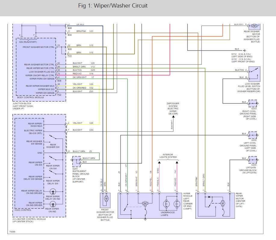

If fuse 19, your "wiper on" and "hi/lo" relays are good, it has to be the switch. The wipers should work on high/low even it the delay function in the multi-function switch is bad. You are losing power somewhere it could be the BCM let's find out for sure by following this guide and the wiper wiring diagrams below.
Check out the diagrams (Below). Please let us know what you find. We are interested to see what it is.

Welcome to the forum, If the wiper motor is not working, I would check voltage at the wiper motor. Red wire with yellow tracer is voltage for high speed, use a test light to check for voltage. Brown wire with white tracer is voltage for low speed. Check either one or both for voltage. Take electrical connector loose from wiper motor, turn the key on, you should not have to start it, turn wiper setting to low, use test light on wire already mentioned. If no voltage, fuse five 20 amp in fuse box, should be for wiper. Other possibilities, wiper linkage is hung-up, wiper motor is faulty, My information did show a 9 amp circuit breaker on ground side of wiper motor, not sure if that is replaceable or part of motor?

It seems strange that the wipers quit "after" you changed the BCM. Was the BCM new or used? Do you have a wiring diagram for the wiper/washer system? If not, if you have, or have access to, a fax number I can ship you one. I can attach it to this post but they do not through very clearly. If the relays and fuses are good, and the switch is new, The only thing left is the BCM. Let me know.

Body computer. The insane engineers can no longer make a simple wiper motor work with complicating the circuit with an unnecessary computer. The result is lots of expensive failures and repair bills. You might want to plug in a multi function switch from a salvage yard first to be sure it is not the cause, but suspect the body computer.

welcome to the forum. There is a wiper on relay in the power distribution center, under the hood. Voltage to the coil and load side of relay, is hot all the time. The BCM grounds the coil side of relay in order to energize. The wiper switch sends a signal to the BCM , the BCM grounds the coil side of wiper on relay. The problem could be almost anywhere, relay wiper switch BCM or wiring circuit. You might have the codes checked, see if it points to anything?
