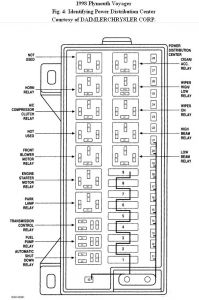

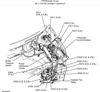

Could you tell me where the wiper on relay circuit is? The picture in the original documents you sent me point to some location that isn't clear to me.

It is in the PDC, Power Distribution Center.
https://images.2carpros.com/forum/automotive_pictures/192750_PDC98VoyagerFig02_1.jpg
https://images.2carpros.com/forum/automotive_pictures/192750_PDC98VoyagerFig04_1.jpg
