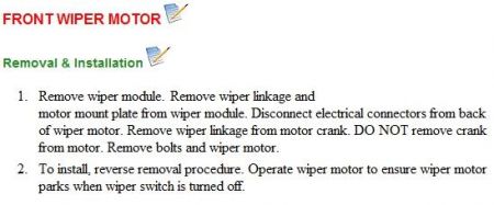

my friends 1998 Plymouth Voyagers wiper motor died on him and I was wondering how hard it is to change

https://images.2carpros.com/forum/automotive_pictures/261618_Noname_1975.jpg
