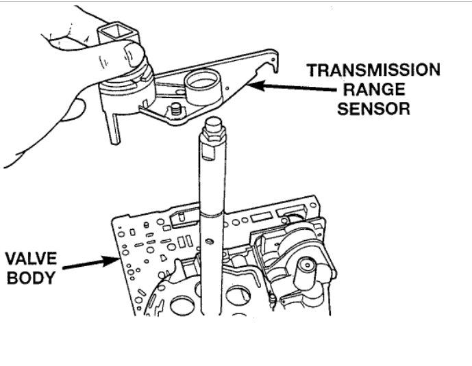

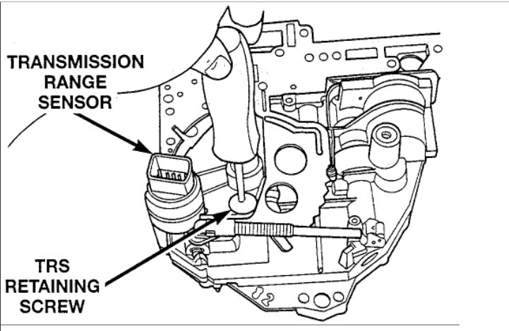

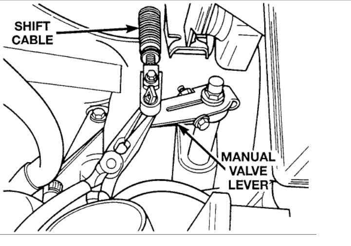

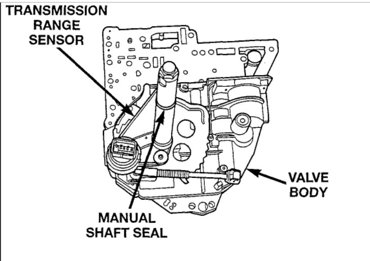

I have searched for days and even called the dealer parts shop trying to determine the difference between:
a) a park/neutral position switch
b) a transmission range sensor
c) a neutral safety switch.
I got a code P1899 on my Plymouth Grand Voyager Espresso w/ 3.3 L engine. 4 speed automatic(or at least I believe it's a 4 speed. Indicator shows PRND3L).
Is there a difference between these parts? Also, given the code P1899, which should I replace. The dealer parts shop nor the local Autozone could confirm which part I need. Help!!!
If the vehicle doesn't have either; then, what would code P1899 mean? The shift indicators are flashing and the trip as well as the trac off lights are coming on.
May 14, 2010 at 6:08 PM
  • 54,859 POSTS
This transmission range sensor is the neutral safety switch all wrapped up into one. Here is a guide on how to service the transmission and replace the sensor (Below)
Please let us know what happens so it will help others.
