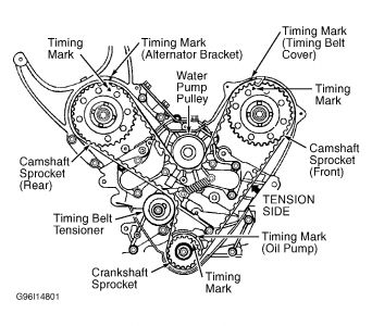

How do I set the cam pullys on timing mark after belt has broken
Thursday, October 9th, 2008 AT 2:37 PM
2 Replies
DOCFIXIT
MECHANIC
18,828 POSTS
Place crank gear mark to mark in oil pump align cam sprockets to mark on cylinder head. Be ADVISED THE ENGINE MAY HAVE BENT VALVES.
Good luck
