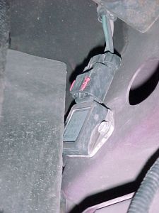

My Voyager radiator cooling fans will not turn off.
ai pulled the connection wires off the heat sensing plug and the fans remained on.
My Haynes manual wiring diagram shows a fan Relay, But does not show where it is.
I will replace it if I can find it. thank you.

the Relay should be located on the drivers side, front inside frame just under or near the radiator. it should look like this.....
https://images.2carpros.com/forum/automotive_pictures/188069_fanrelay_1.jpg

Here is a picture of the relay in it's location in the van.
https://images.2carpros.com/forum/automotive_pictures/222354_MVC442F_3.jpg
