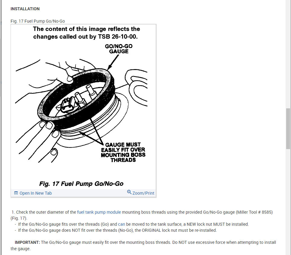

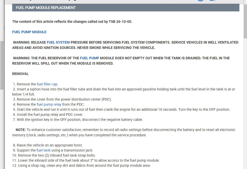

The low fuel light keeps coming on and going right back off. There is plenty of gas in the van and it only stays on for a split second. The dinging is the most annoying part. I checked with my normal mechanic and he said it is actually in the gas tank and it will be $100.00 alone to drop the gas tank and another $150.00 or higher to replace this part. My question is, is there a fuse to just disable the indicator from coming on in the car. Will this affect any other car functions?
Mar 24, 2010 at 2:27 PM
  • CAR REPAIR CONTRIBUTOR

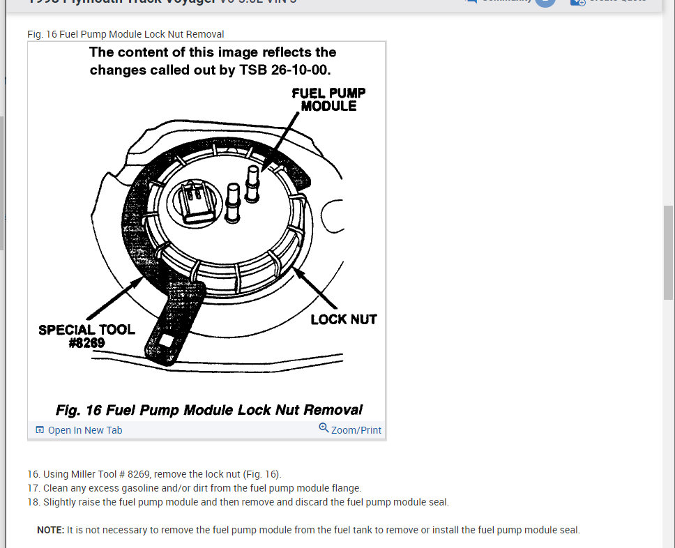

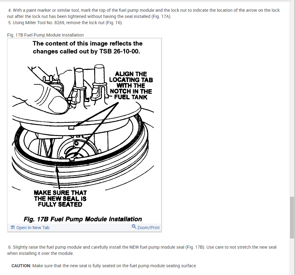

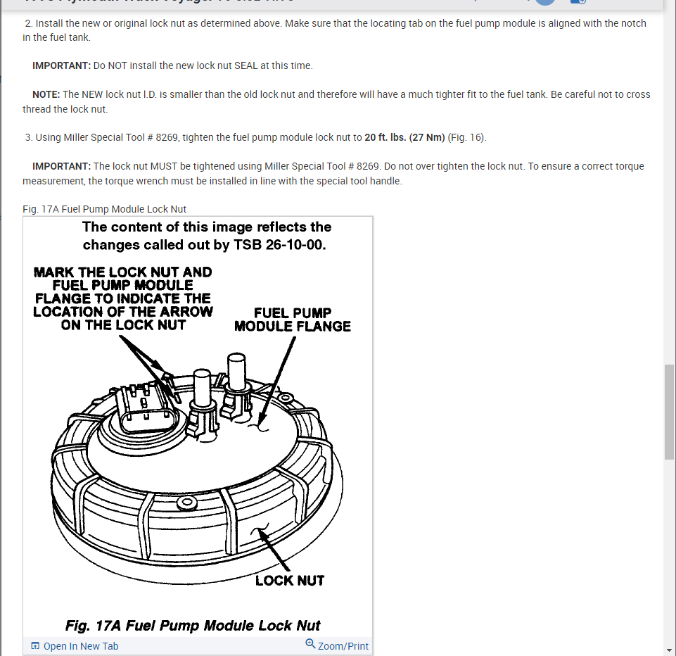

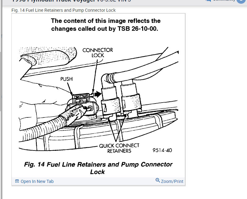

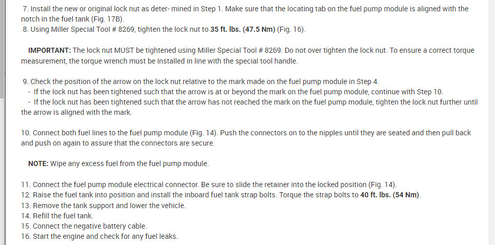

Unfortunately this is not a fuse issue. This will require a fuel pump to be removed and I would just replace it since it is out.
Here is a guide that helps with this:
https://www.2carpros.com/articles/how-to-replace-an-electric-fuel-pump

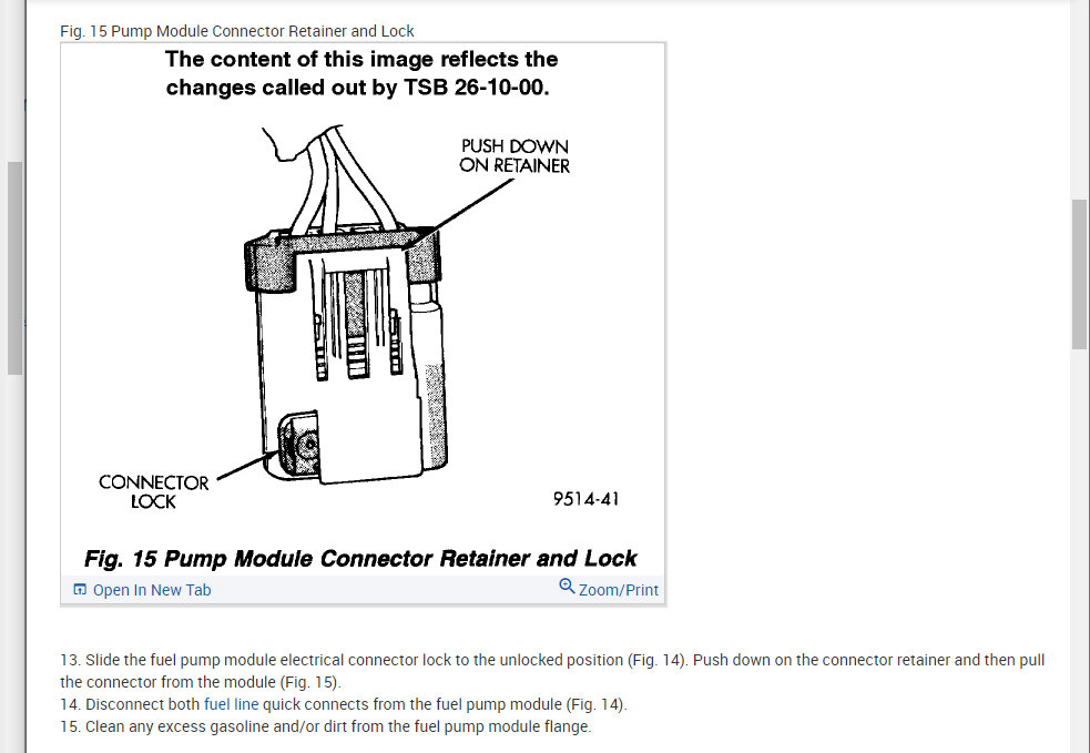

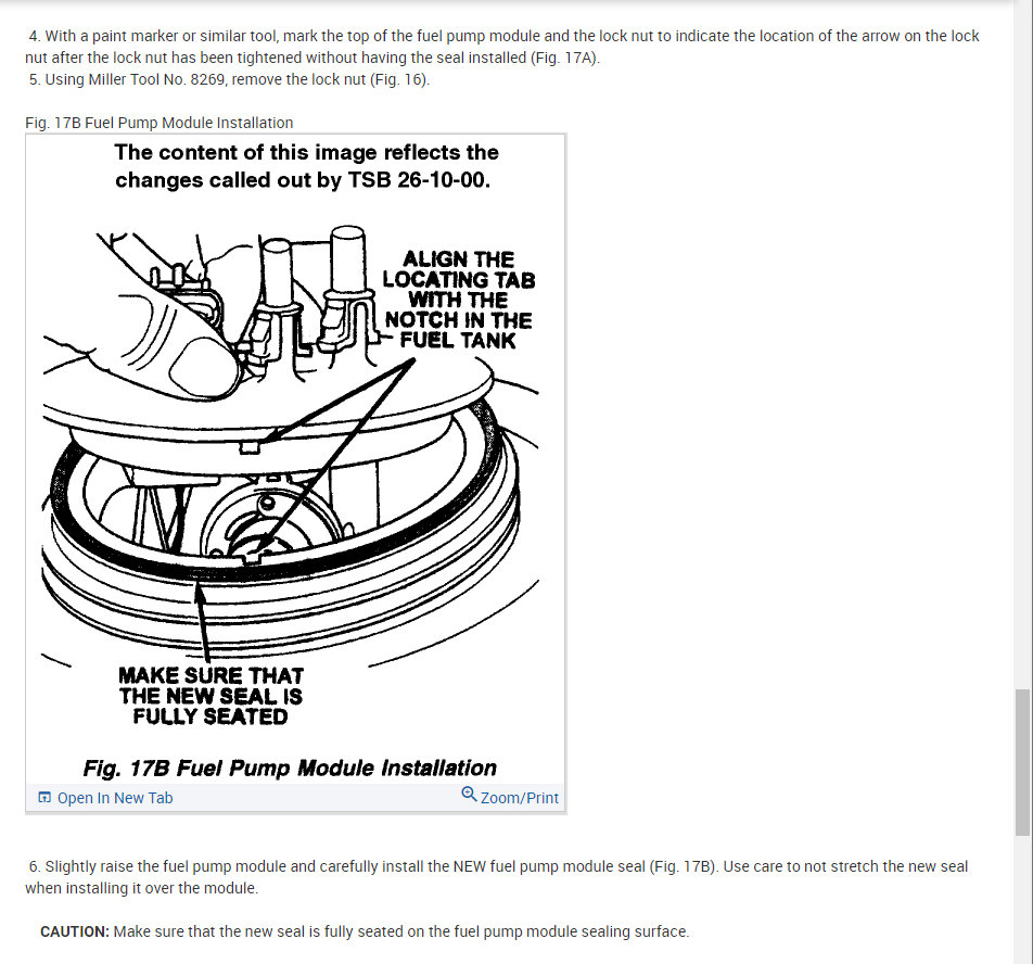

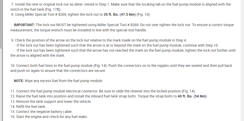

Please see the process from the manual below and let us know if you have other questions. Thanks
