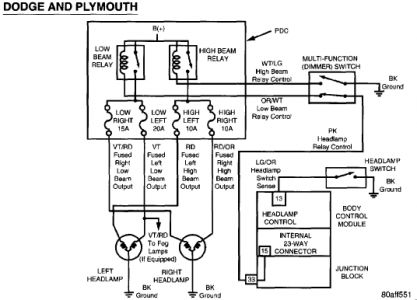

turn on car lights come on. stay on till car shuts off 5 min. delay..only at night the lights come back for no reason 4 5 min. then start flickering,then in the morn. I have to jump start it.. I have removed the front light fuses and the panel fuse and have had no problems..as long as I put them back before I drive at night..fuses good..should I get a priest, or a new manvan

You need to see what is being commanded. Hope you can read this. If you have a problem e-mail me at underthecarguy@aol.com and make sure you tell me what you are e-mailing me about. HTH.
