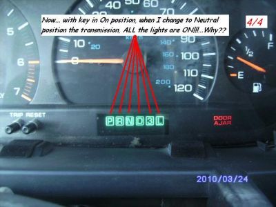

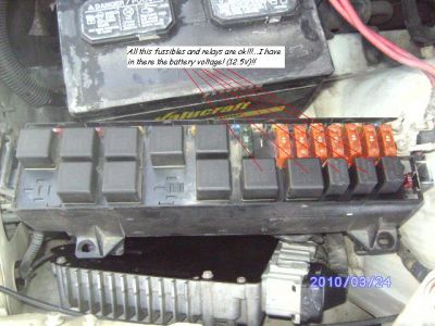

TECPROMOVIL
https://images.2carpros.com/forum/automotive_pictures/504127_PICT0010_1.jpg
https://images.2carpros.com/forum/automotive_pictures/504127_PICT0011_1.jpg
https://images.2carpros.com/forum/automotive_pictures/504127_PICT0013_1.jpg
https://images.2carpros.com/forum/automotive_pictures/504127_PICT0014_1.jpg
https://images.2carpros.com/forum/automotive_pictures/504127_PICT0023_1.jpg
https://images.2carpros.com/forum/automotive_pictures/504127_PICT0024_1.jpg
https://images.2carpros.com/forum/automotive_pictures/504127_PICT0025_1.jpg
https://images.2carpros.com/forum/automotive_pictures/504127_PICT0026_1.jpg
https://images.2carpros.com/forum/automotive_pictures/504127_PICT0027_1.jpg
https://images.2carpros.com/forum/automotive_pictures/504127_PICT0035_1.jpg
Mar 25, 2010 at 1:59 PM
LEGITIMATE007
  • 5,121 POSTS
ok that is definitely a problem with the body control module, have you notice that before? all the lights coming on like that.
