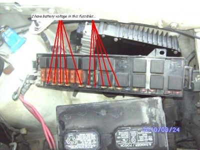

No star. No run. All fusibles, connectors and circuits are ok. All relays are ok. Fuel pump and starter no work. I have a problem with PCM or Electronic Chassis Control Module??? I don`t know!!!

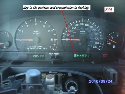

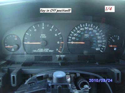

what happens when you turn the key to the on position? what happens when you try to start the vehicle? anything? please elaborate more

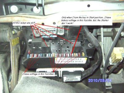

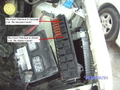

When I turn the key to the ON position: the fuel pump don`t work...the fuel pump relay, circuit and fusible are ok!
When I turn key to START position: the starter don`t work...the starter relay, circuit and fusible are ok!
The fuel pump and starter...are ok!
Thanks for your help!!!... ;-)

are you getting power to the power distribution center?
Mar 23, 2010 at 10:15 PM

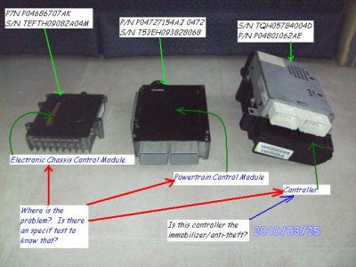

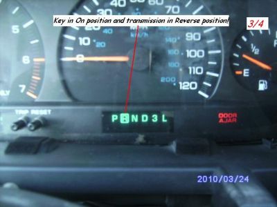

TECPROMOVIL

Mar 25, 2010 at 8:59 PM
LEGITIMATE007
  • 5,121 POSTS
ok that is definitely a problem with the body control module, have you notice that before? all the lights coming on like that.
Mar 25, 2010 at 9:39 PM
TECPROMOVIL
[quote:b9e740f9ec="legitimate007"]ok that is definitely a problem with the body control module, have you notice that before? all the lights coming on like that.[/quote:b9e740f9ec]
Hello!...I need your help again.....
I did replace the BCM with a new unit...but I have the same problem...NO work the starter....No work the fuel pump.
And when I connect the battery...the EATX shutdown relay click on!!!....
what is the problem???....I did test all circuits and they are OK...

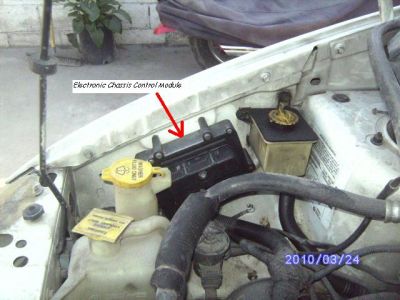

with the engine and transmission sensors disconnected....the PCM disconected ...the EATX shutdown relay DON`T click on!!!.... This EATX shutdown relay, click on only with the Electronic Chassis Control module connected!!!
What I need to do???...please help me!!!
Jul 3, 2010 at 3:08 PM
LEGITIMATE007
  • 5,121 POSTS
you will need to have the chassis control. tested and or replaced, it seems to be pulling too many amps thus causing the fuse to blow
