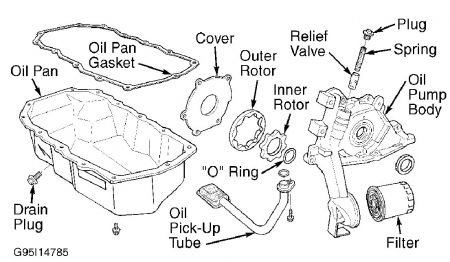

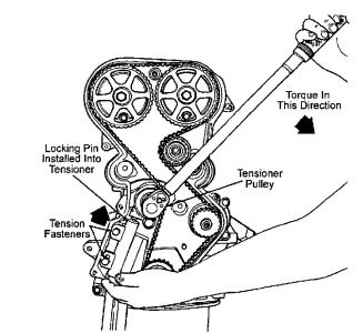

Paul, after doing further research, it turns out that my 2.4L engine is an interference engine. Timing belt failed on highway and stalled. 1 try to turn engine over resulted in whining/whirring sound no start. What is the likelhood of damage to other parts of the engine? If there is damage, what are the likely items that could be damaged? I am trying to determine whether it is worth fixing. Are the Oil Pump and Water pump driven by the timing belt or inside the cover of the timing belt?

You need to pull the head and get a look or replace the belt and try it and see what happens. I have seen everthing from it running fine, to running rough to not starting on an interference motor.
Potential damage is a cracked head, bent valves and/or pistion face damage.
Just the sprocket stick out, the inner cover needs to be removed to get to the pumps.

TURNS OUT OIL PUMP SEIZED UP, STRIPPING TEETH OFF OF TIMING BELT, SIMULTANEOUSLY CAUSING THE REAR CAM TO SIEZE. AT THE VERY LEAST WILL NEED NEW TIMING BELT, OIL PUMP AND NEW HEAD. IF LUCKY, NO DAMAGE TO THE BLOCK OR PISTONS, BUT I AM NOT FEELING TOO LUCKY.
ANY FEEDBACK YOU CAN GIVE THAT WOULD MAKE ME FEEL BETTER WOULD BE APPRECIATED.
