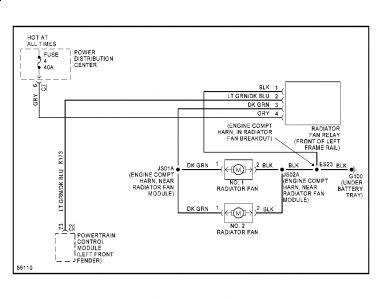

The plug-in harness to the fan control mudule, I need to know the color termination left to right looking at the blades of the connector.

BLK LT GRN/DK BLU DK GRN CRY
https://images.2carpros.com/forum/automotive_pictures/99387_Graphic1_519.jpg
