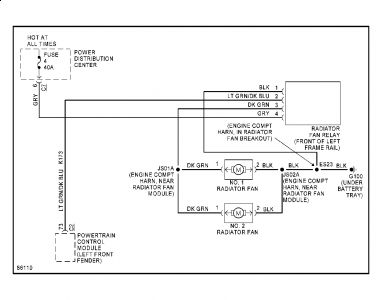

I need to know the wire color termination to the cooling fan module, it has four wires.

BLK LT GRN/DK BLU DK GRN CRY
https://images.2carpros.com/forum/automotive_pictures/99387_Graphic1_518.jpg
