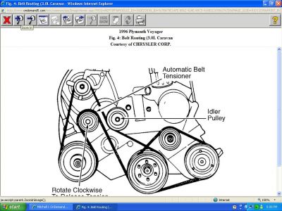

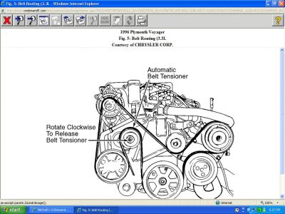

HELP!!!! I drive a 1996 Plymouth Voyager. Had the serpentine belt replaced by reputable mechanic. Took it back once to be tightened, because of constant squeek. Started squeeking again. Boyfriend sprayed Belt Dressing on it while running - Belt slipped off!!! How do we get it back on w/out paying for $80 tow????
THANK YOU!
Nov 17, 2008 at 2:53 PM
JNOVACK
  • 723 POSTS
on 3.0 engine this is the belt routing
https://images.2carpros.com/forum/automotive_pictures/52960_belt2_1.jpg
3.3 and 3.8 engine this is the belt routing
https://images.2carpros.com/forum/automotive_pictures/52960_belt1_1.jpg
use wrench and turn belt tensioner clockwise to put belt back on after routing
