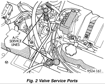

1996 Plymouth Voyager 6 cyl Automatic
Where is the low pressure service port on a 1996 plymouth voyager?
Jun 25, 2010 at 9:57 AM
  • 75,992 POSTS
https://images.2carpros.com/forum/automotive_pictures/12900_ac1_1.gif
HIGH SIDE The A/C service port valve cores are located within the A/C lines. The High Side (Discharge) valve service port is located on the liquid line near the right frame rail.The High Side service port is a two piece port and is serviceable. LOW SIDE The Low Side (Suction) valve service port is located on the suction line near the compressor. The Low Side service port is not serviceable, the suction line would have to be replaced.
