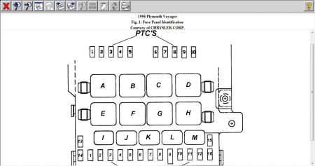

hi guys
my engin cut out wile I was driving the fuel relay switch dos not clik and the fuse is ok so I used a bit of easy-start it started for a second and made a taping sound then I realised that there are two shtdown relays on either side of the fuel pump relay can you please tel me what (EATX shutdown relay) and (AOUTO SHUTDOWN relay is for and advise me on what to do. Thank you guys.

Check fuse PTC1 9amp and fuse no.13 20amp and get back with me. BTW all you got is one ASD relay

The no.13 20 amp is ok, but where is the PTC1 9 amp?
I do have a constant spark. The engine stalled, and has not started since.
If possible could I please have some diagrams/pictures??
Also, what does the ASD do? What triggers it?

The PTC1 fuse 9amp is in the junction block left side of instrument panel. Be advised the Auto shutdown reelay has nothing to do with the fuel pump circuit.
Turn key On and at the fuel pump relay receptacle check for power on the white and black wire -Do you have it?

I tried locating the PTC1 fuse I found a fuse block on top left hand side of the drivers foot-well and none of them are marked as PCT1 can you please let me know how to find it
Oct 22, 2009 at 1:47 PM
  • 75,992 POSTS
See below
https://images.2carpros.com/forum/automotive_pictures/12900_ptc1_1.jpg
