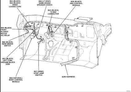

where is the blower motor relay. it's not under the hood/ and i can't find it under the dash with those relays.any help would be appreciated and if and when i find it how will i know it's the right one? thanx

Hello, if it isn't under the hood, that shot me down. My info said it was in the power distribution center, under the hood. Maybe not??
If you can see the relay wires, I match the color of the wires at the relay connector, with the color of the wires on the wiring diagram, if I'm not sure which relay is which. If the relay just plugs into a socket, where you can't see the wiring colors, it makes it awkward. If it is in a power distribution center, the lid for the box, should be labeled.

https://images.2carpros.com/forum/automotive_pictures/170495_blower_relay_2.jpg
The Front Blower Motor Relay (A/C Relay) is behind the Junction Block with a black connector, B05.
