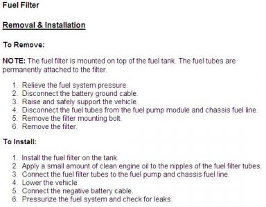

How do you change a fuel filter above the gas tank on 96 voyager

https://images.2carpros.com/forum/automotive_pictures/170934_fuel_filter_1.jpg
I found this procedure.
