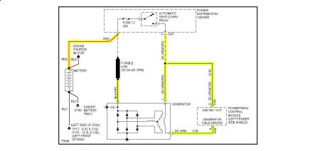

I have a 1996 Plymouth Voyager and have replaced the battery and alternator. If the battery if is fully charged I can drive it for about an hour or so on the freeway then it will loose all power. The speedometer will go crazy and lights will flicker and the transmission acts like it doesn't want to shift then nothing. What can be the problem?

Check fuse no. 12 25amp and also the fusible link if okay have the computer generator driver circuit checked out-See below
https://images.2carpros.com/forum/automotive_pictures/12900_alty_71.jpg
