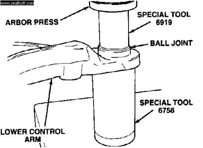

I need to replace the Bolljoints. Has anyone replaced them on the car?
Nov 13, 2007 at 1:37 PM
BMRFIXIT
  • 19,053 POSTS
here what the book say about changing the ball joint
