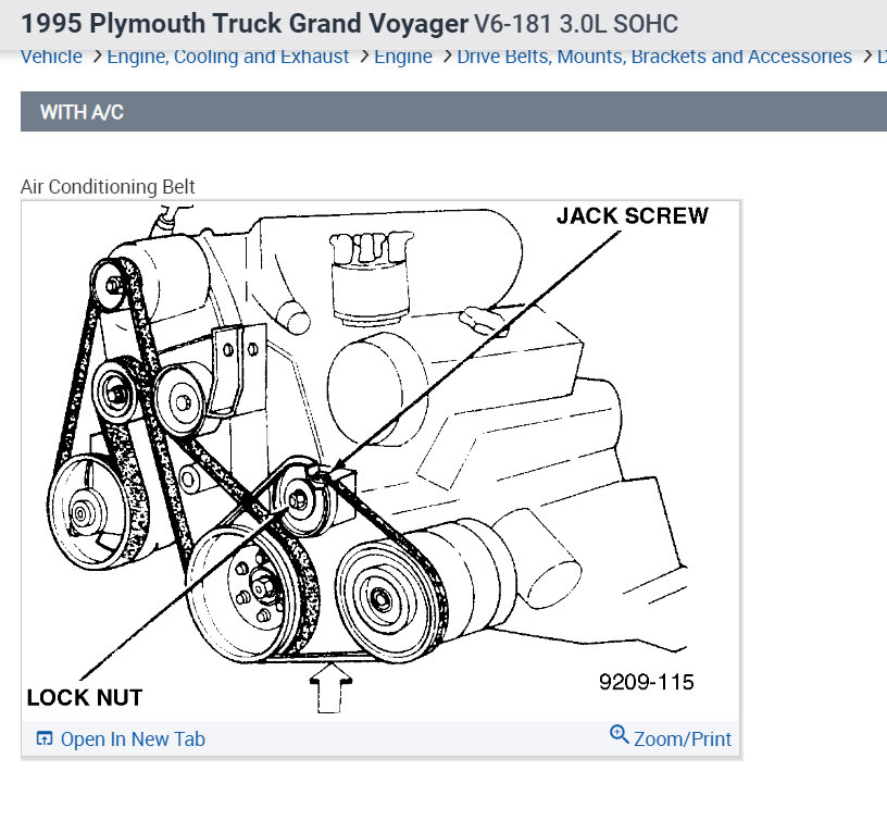

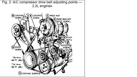

the van doesnt have any belt diagrams and the ac belt is gone ive purchased a new belt not realy sure how the new one goes on. any advice would be greatly appriciated.
May 26, 2010 at 5:34 AM
INTERNETMECHANIC
  • 700 POSTS

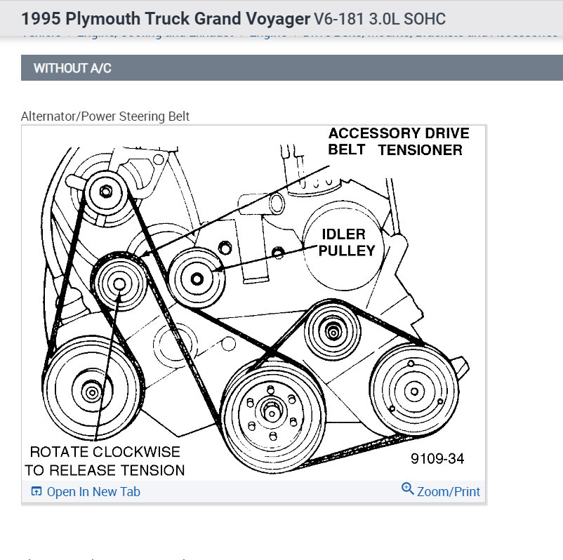

I found this belt routing diagram. Note the engine litre size. If the diagram doesn't match your vehicle, ignore.
https://images.2carpros.com/forum/automotive_pictures/512072_voyager_belt_routing_1.jpg
Check the v6 belt diagrams below
