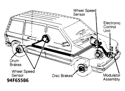

Yes i need to know how to pot abs in my van.. the part stor tell me i need a ABS PUMP & MOTOR wote is that and ware woulde i find in in the van and do i need any wire's to pot them in? thank you darknight

your van is already fitted with ABS .. do you want to replace part's ?? DESCRIPTION NOTE:For more information on brake system, see appropriate BRAKE SYSTEM article in the BRAKES Section. Bendix-4 Anti-Lock Brake System (ABS) is designed to prevent wheel lock-up during heavy braking. This allows operator to maintain steering control while stopping vehicle in shortest distance possible. Major components are master cylinder, vacuum booster, modulator and pump/motor assembly, wheel speed sensors, and Controller Anti-Lock Brake (CAB). See Fig. 7 . ABS also includes 2 warning lights (Red BRAKE and Amber ANTI-LOCK). ABS has a self-diagnostic system for trouble shooting and system malfunction warning. ABS uses hydraulic power assist for normal power-assisted braking and to provide a source of high-pressure hydraulic fluid during anti-lock braking. Pedal feel is similar to conventional vacuum-boosted brake system. If additional force is applied during anti-lock stop, or if brake pedal is released and re-applied rapidly, driver may notice a very hard pedal feel. This is due to isolation of master cylinder during ABS operation, as wheel brake pressure is fed from modulator assembly. Fig. 7: Locating ABS Components (Typical) Courtesy of CHRYSLER CORP.
https://images.2carpros.com/forum/automotive_pictures/266999_abs_1.jpg

your van already has ABS fitted .. 1994 plymouth voyager ...
fuse 11 - 15 Amp (Lt. Blue)
Stop Lamps, ABS Controller.
I don't understand what you want to do ... the van has ABS already ??
