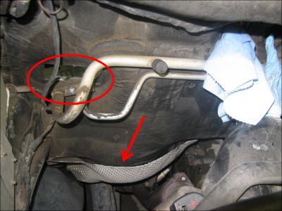

The first pic is from looking in the engine bay. The circle is the A/C lines going into the car at the firewall. On this model, the rubber tube that the water comes out is behind the shield where the arrow is.
https://www.2carpros.com/forum/automotive_pictures/248015_Picture1_67.jpg

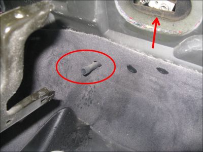

The next pic is from inside the car. . .. . .. . ..the circle is the end of the hose that connects to the HVAC system to drain the condensation. The arrow is the part where the AC lines come into the cab.
https://www.2carpros.com/forum/automotive_pictures/248015_Picture2_48.jpg

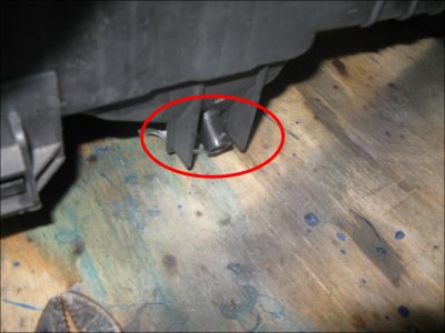

The next pic is the outside part of the HVAC that the hose connects to. The entire HVAC is inside your car. . .. . .
https://www.2carpros.com/forum/automotive_pictures/248015_Picture3_31.jpg

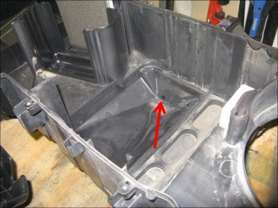

The last pic. . .. . ...the arrow shows the drain hole that the condensation collects and drains out to the rubber hose then out of the cab. As you see, this is the lowest point in the HVAC housing. So it fills with water since it cannot drain out and flows throw to a point to leak out. Now be careful as the evaporator sits right there so you don't want to push too hard or you will poke a hole in it then you will not have any AC and you will have a tough time replacing that!. So poke easy and use the air.
https://www.2carpros.com/forum/automotive_pictures/248015_Picture4_25.jpg

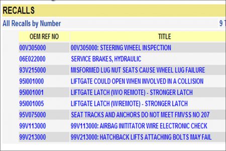

Hey, one other things. Also, it looks like you may have some recalls on your vehicle. The dealer may fix these for free. Please contact the dealer service department, give them the VIN number of your car and have them check on these to see if they apply to you.
https://www.2carpros.com/forum/automotive_pictures/248015_Recalls_33.jpg
