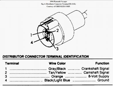

No start condition with code 54 no fuel sync triggered , has spark , vehicle has 228000 kms and is a canadian vehicle with a 3.0 L V6 , from what info I can find no camshaft position sensor or crank sensor ( pretty sure about the cam sensor but not the crank ) took a compression test to check if maybe the timing belt slipped and compression is 120 psi . Could it be the hall pick up in the distributor , any tests I can do on it ? Any help appreciated as always .

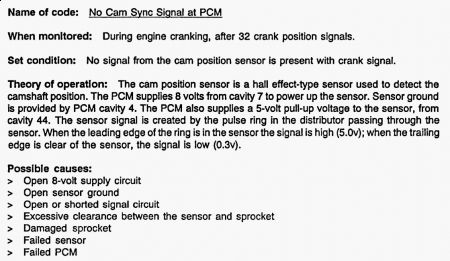

54= No cam signal detected. remove the distributor cap and see if rotor turns as engine is cranked. Code 54 DRB displays CRANKSHAFT SIGNAL SYNC PICK-UP SIGNAL. Condition is: no fuel sync signal detected during crankshaft rotation. Code 54 DRB displays NO CAM SYNC SIGNAL AT PCM. Condition is: open or shorted condition detected in cam sync signal circuit. TEST TC-3A - NO CAM SYNC SIGNAL AT PCM (DTC 54) 1. Using DRB, erase trouble codes. Attempt to start engine. If engine will not start, crank engine for at least 20 seconds. Using DRB, read trouble codes. If DRB does not display NO CAM SYNC SIGNAL AT PCM, go to next step. If DRB displays NO CAM SYNC SIGNAL AT PCM, go to step 4). 2. At this time, condition required to set trouble code is not present. NO CAM SYNC SIGNAL AT PCM trouble code sets if Powertrain Control Module (PCM) does not see a camshaft position sensor signal with crankshaft position sensor signal present. Possible causes are: open or shorted crankshaft position sensor Orange wire, open crankshaft position sensor Black/Light Blue wire, open or shorted camshaft position sensor Gray/Black wire, damaged pulse ring, failed sensor, or failed PCM. Go to next step. 3. Inspect all related wiring and connectors. Repair as necessary. Perform TEST VER-2 . If wiring and connectors are okay, see INACTIVE TROUBLE CODE CONDITION in this article. Perform TEST VER-2. 4. Turn ignition off. Disconnect and inspect distributor connector. Repair as required. Perform TEST VER-2. If distributor connector is okay, go to next step. 5. Turn ignition on. Using DRB in voltmeter mode, check voltage of distributor connector (harness side) Tan/Yellow wire. If voltage is more than 4 volts, replace camshaft position sensor. Perform TEST VER-2. 6. If voltage is less than 4 volts, turn ignition off. Disconnect PCM connector. Using an external ohmmeter, check resistance of camshaft position sensor Tan/Yellow wire between distributor connector (harness side) and PCM connector terminal No. 44. 7. If resistance is more than 5 ohms, repair open in Tan/Yellow wire. Perform TEST VER-2. If resistance is less than 5 ohms, go to next step. 8. Using DRB in ohmmeter mode, check resistance of PCM connector terminal No. 44 (Tan/Yellow wire). If resistance is less than 5 ohms, repair short to ground in Tan/Yellow wire. Perform TEST VER-2. If resistance is more than 5 ohms, replace PCM. Perform TEST VER-2. NOTE: For circuit and connector terminal identification, see CONNECTOR IDENTIFICATION in this article. For wiring diagrams, see WIRING DIAGRAMS.

Once again this engine has no camshaft position detector , is the signal just through the distributor , is there a crank sensor , I am not using the drb but can still use a voltmeter , a response that involves real life experience rather than cut and paste from a manual would be appreciated . thanks

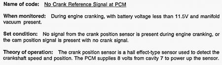

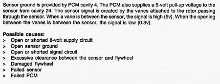

This is what I found, but cam sensor is in the distributor. Test using this Tech bulliten proceedure.
