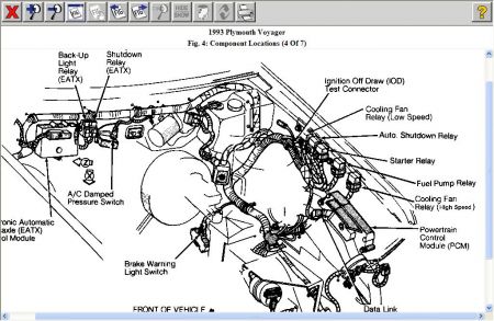

Where is the starter relay on a 93 voyager w/ 3.3, auto?
Aug 1, 2008 at 2:04 PM
  • 75,992 POSTS
See below
https://images.2carpros.com/forum/automotive_pictures/12900_relay_16.jpg
