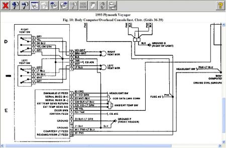

i have a console compass,ice,lights and want to use on another van need to know what the voltages are on the 6 wired plug

Hi Don, Thank you for the donation. Are you refering to the overhead console 6 wire plug? I have attached a diagram for you to refer. Hope it is the correct one. Terminal # 3 requires battery voltage and terminal # 4 is the ground. The others are for operations of the vent motors.
