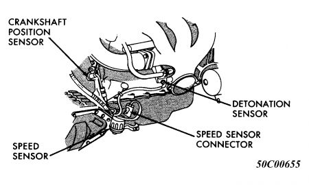

I have a chiltons manual and the diagram does me no good. I can't find it. Where on the transaxle housing is the sensor. Do I need to take the drivers side front wheel off to see/get at it?

Its a bear to find.It is located on top of the bellhousing, under the exhaust croos over, towards the firewall.

You pretty much have to get under the car, behind the crossmember, and look forward at the back of the bellhousing to see it.

That's exactly what I did, and even then it was a pain to get at. It was harder to find because the wires were sheared off right at the sensor. I found the harness it plugs into before I found the sensor. It was a big job for one little bolt, but it's done and running fine again. Thanks for your help
