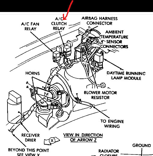

I get in the van and turn the key.......nothing happens....no clicks..no sound...nothing at all. I put in a new battery and the engine starts and runs great. The next morning I try to start it and it is dead again...no sound..no click..nothing.
What could be the problem?

you have a short somewhere draining your battery....or...their is a bad connection clean the terminals and ground connections

I have seen the AC clutch relay stick on which drains the battery out, her are two guides to help us fix the problem and I have included the location of the AC clutch relay so you can remove it over night to see if that fixes the problem.
and
https://www.2carpros.com/articles/car-battery-dead-overnight
