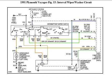

where is relay for wipers located
May 30, 2010 at 8:51 AM
MHPAUTOS
  • 31,937 POSTS
Hi there, Looking at wiring schematic, there appears that there is no individual wiper relay, it is controlled by the ECU and the switch, see pic.
