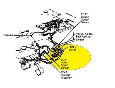

i do not have reverse light s and i checked bulbs and fuses i'm stummped please help needed for safety

check neutral safety switch
https://images.2carpros.com/forum/automotive_pictures/99387_91_ply_1.jpg
