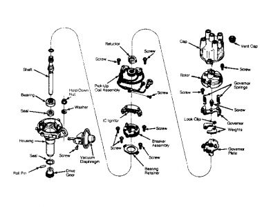

Hello and happy new year.
I have bought a 1987 Plymouth Voyager 2.6L 4Cylinders Mitsubishi.
But there is no ignition.
I have changed the rotor, the coil, the pick up the sparkplugs and sparkplugs wire, but ther is no ignition.
Do you have an idea or maybe the electrical diagram ?
Thanks a lot ofr your help.

Hi most likely a faulty igniter check for voltage at coil positive if good put test light on coli negative crank does it flash? if not igniter is faulty.
https://images.2carpros.com/forum/automotive_pictures/198357_Graphic_309.jpg
Let me know Thanks for donate

Thank you for your answer.
The positive seems ok, because a light i have connected on the positve of the coil turns on when i turn the key.
But the negative seems not working.
So i think the problem comes form the negative of the coil.
