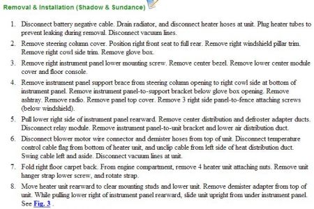

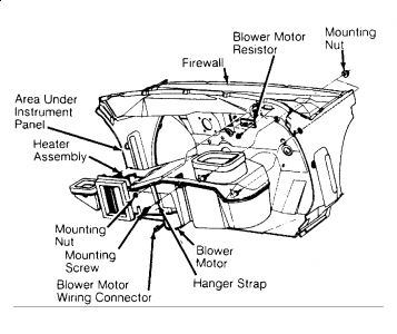

1994 Plymouth Sundance 6 cyl Front Wheel Drive Automatic
I'm trying to get to the heater core. I have the hole dash out. But I can't figure out how to get the plastic cover off the heater core which is on the firewall.

BLUELIGHTNIN6
  • 16,542 POSTS
https://images.2carpros.com/forum/automotive_pictures/261618_Noname_1622.jpg
https://images.2carpros.com/forum/automotive_pictures/261618_Noname2_497.jpg
https://images.2carpros.com/forum/automotive_pictures/261618_Graphic_319.jpg
Feb 10, 2010 at 2:33 PM
