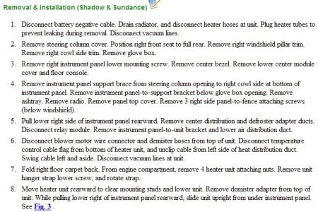

I'm trying to get to the heater core. I have the hole dash out. But I can't figure out how to get the plastic cover off the heater core which is on the firewall.

https://images.2carpros.com/forum/automotive_pictures/261618_Noname_1622.jpg
https://images.2carpros.com/forum/automotive_pictures/261618_Noname2_497.jpg
https://images.2carpros.com/forum/automotive_pictures/261618_Graphic_319.jpg
