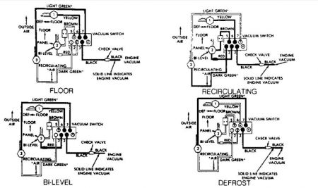

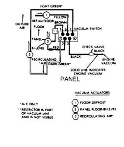

have changed the control mechanism but still only blows defrost .I suspect the main or supply vacoum line is out . Which colour is the supply line and where does it hail from. Thank You. Padraic
