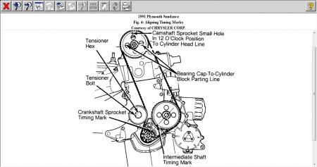

where are the timing marks and where do they need to be to replace a timing belt
Jul 26, 2009 at 3:33 PM
  • 75,992 POSTS
Put the engine no.1 piston on its compression stroke/TDC and line everything up as you see below
