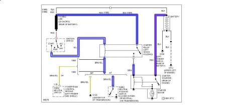

Is it cranking over and will not start or just won't crank at all/nothing?? If it cranking over and will not start-do below to determine if its fuel or spark problem. Get helper disconnect a sparkplug wire or 2 and ground it to the engine -have helper crank engine over-do you have a snapping blue spark? If so-you have a fuel related problem, check the fuel pressure to rule out the fuel filter/fuel pump/pressure regulator and listen to the injector/s are they pulsing or hook up a noid light. No snapping blue spark continue to troubleshoot the ignition system-power input to the coil/coil packs,distributor pick-up coil, ignition control module, cam and crank sensors- Note: If it doesn't apply disregard it Won't crank at all/nothing Could be the starter, stater relay, park and neutral position switch and ignition switch. Do this disconnect the yellow wire at the starter relay have helper hold key at start position do you have power?

Tp locate the starter Follow the battery positive cable to the starter relay and then to the starter
https://images.2carpros.com/forum/automotive_pictures/12900_starter1_16.jpg
Starter

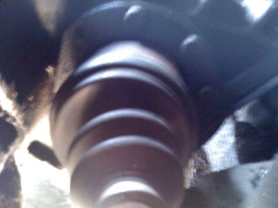

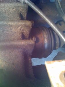

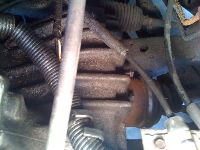

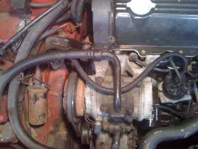

RYAN RYAN

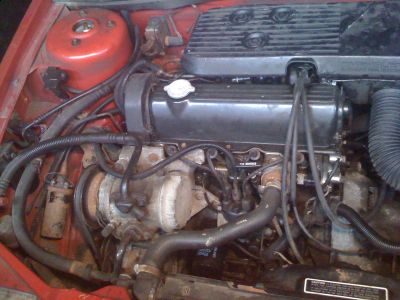

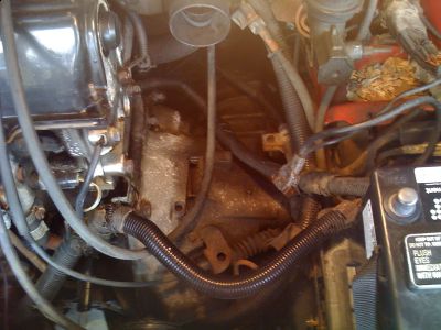

Here are some picutres to verify I am dealing with the starter. It is on the right side of the engine? At first I thought it was this little thing on the left side of the hood but it must be something else?
https://images.2carpros.com/forum/automotive_pictures/350121_abvabovestr_1.jpg
https://images.2carpros.com/forum/automotive_pictures/350121_abovestr_1.jpg
https://images.2carpros.com/forum/automotive_pictures/350121_abovestr2_1.jpg
https://images.2carpros.com/forum/automotive_pictures/350121_undrstr_1.jpg
At first I thought it was this little thing on the left side of the hood but it must be something else? All the way on the left has two wires connected to two bolts, seems more like the description of the starter.
https://images.2carpros.com/forum/automotive_pictures/350121_leftside_1.jpg
https://images.2carpros.com/forum/automotive_pictures/350121_zoomleft_1.jpg
Jul 5, 2009 at 8:30 AM
  • 75,992 POSTS
I don't see the starter the only thing I see is the AC compressor and below it is the alternator pic 5/6.
Follow the battery positive post cable either it will take you to a starter relay and from there it will go straight to the starter. Normally the starter is in between the engine and transmission.
