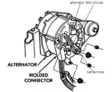

Just to add, the info shows the alternator field circuit is controlled by the computer.
https://www.2carpros.com/forum/automotive_pictures/170934_reliant_1.jpg
If your molded connector looks like the picture, the two smaller terminals are for the field terminals, engine running, one is hot, the other has a pulse.

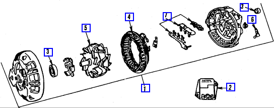

Its no.2 on the pic-my guess its on the firewall/fender its mounted seperately-Easter hunt time
