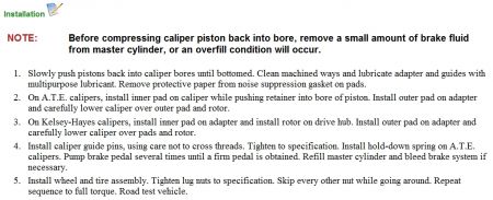

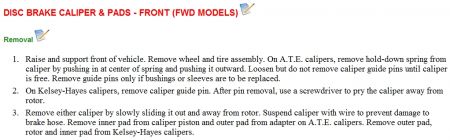

what is the proceedure for replacing my front brake pads on my 1988 plymouth reliant? please help,i'm stuck!

https://images.2carpros.com/forum/automotive_pictures/261618_Noname_2762.jpg
https://images.2carpros.com/forum/automotive_pictures/261618_Noname2_897.jpg
