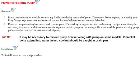

how do i remove the power steering pump on my 1988 plymouth reliant? i have all the bolts loose. what can be holding it tight? do you have a diagram of the bolts on it? your answer is much appreciated. thank you.

https://images.2carpros.com/forum/automotive_pictures/261618_Noname_2514.jpg
