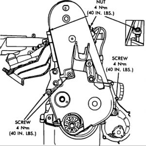

Fig. 13 Timing belt cover removal.
https://www.2carpros.com/forum/automotive_pictures/12900_t1_23.jpg
Remove the nuts securing the timing belt cover to the cylinder head and the cylinder block, then the timing belt cover halves.

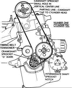

Cam Belt Routing
https://www.2carpros.com/forum/automotive_pictures/12900_t2_14.jpg
Loosen the timing belt tensioner, then remove the timing belt.

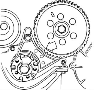

Fig. 1 Crankshaft And Intermediate Sprocket Timing Marks
https://www.2carpros.com/forum/automotive_pictures/12900_t3_7.jpg
Rotate the crankshaft and the intermediate shaft until the markings on the sprockets are aligned as shown.
Fig. 2 Camshaft Sprocket
https://www.2carpros.com/forum/automotive_pictures/12900_t4_2.gif
Rotate the camshaft until the arrows on the hub are aligned with the No.1 camshaft cap to cylinder head line. The small hole must be located along the vertical center line.
Be certain that all timing marks are still aligned.
Cam Belt Routing
https://www.2carpros.com/forum/automotive_pictures/12900_t5_4.jpg
Install the timing belt. Recheck all alignment marks.

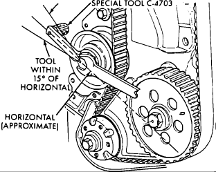

Fig. 21 Adjusting drive belt tension
https://www.2carpros.com/forum/automotive_pictures/12900_t6_2.gif
Set the belt tension, so that the Chrysler belt tension tool's (#C- 4703) axis is within 15 °of horizontal.
Rotate the crankshaft two revolutions in the clockwise direction, then position at TDC. Tighten the tensioner locknut.
