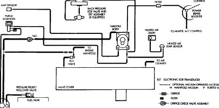

I have a 1992 Plymouth Sundance 2.2 Lt 4Cyl and I have a vacuum line missing. The diagram shows it connects the purge selinoid to a hose that connects the air temp sensor to the throttle body. I can put a hose on it but I can't find the air temp sensor or where the hose goes into the throttle body. All the hoses on my diagram are there and hooked up except that one. The hose comes out of the purge selinoid and ends behind the valve cover and theres a tip on it that has 2 holes on it. If you have a similar car and can send me a pic of the hose showing where it hooks to the throttle body that would be great. Thanks.
[img:22e1869c37]http://www.2carpros.com/forum/automotive_pictures/55787_IM001557_3.jpg[/img:22e1869c37]

im looking at the diagram and it shows two lines from the purge sol one goes to the vapor canister and the other is on a tee with the egr vac and the air temp sensor into the front of the throttle body on the drivers side jim
https://images.2carpros.com/forum/automotive_pictures/59481_Noname_3.jpg

Yeah my dad says he thinks that is where it tee's off but there is an electrical connector coming out of a wire harness beside the throttle body but can't find where it plugs into. I think the female connector it plugs into was hooked to the vacuum line and thats whats missing. Its oval with 2 holes in it. Looks like the ones plugged into the throttle body.

I THINK YOUR RIGHT , SEE THE TEES AT THE CRAPPY DIAGRAM , ON THE LEFT FRT PORT
