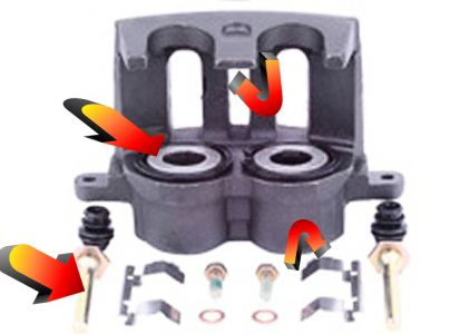

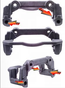

No they are just slip offs. Neons can be squeeky when pads are replaced. Do a good job of cleaning and lubing.

https://images.2carpros.com/forum/automotive_pictures/30961_caliper_lubeareas_10.jpg
https://images.2carpros.com/forum/automotive_pictures/30961_caliper_lubeareasbrack_10.jpg
