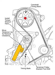

I was just wondering about how much would I be looking at for someone to replace a timing belt and water pump. Or is it an easy job where anyone like me can do it?

what model do you have .
in general $ 300 to $ 400

I have a 1998 Neon. It's an automatic and SOHC with 118000 miles or so. Do you think it's worth the money or do you think I can do it myself?

You cant buy tires for that price if the car in a good shape why not as for doing it you self itsnot an easy job if you have no experience in turning wrenches let me know is you are going to do it your self i will send you more info. if needed
https://images.2carpros.com/forum/automotive_pictures/99387_neon_sohc_2.jpg
