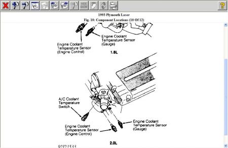

I have a 93 Plymouth Laser, and i just replaced the radiator, fan sensor, alternator, and battery. The problem is the fans are not turning on. After i replaced the sensor they kicked on when the temp gauge reach the half way point while sitting in my driveway. I took it around the block and the fans wouldn't come back on, and the temp gauge was almost maxed. What could it be?

Check the cooling fan thermosensor located in lower right rear of radiator. Also see below
https://images.2carpros.com/forum/automotive_pictures/12900_sensorgauge_sending_unit_1.jpg
