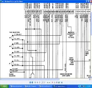

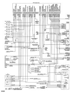

1992 Plymouth laser 1.8, injector #2 not getting impulse/power. How do I trace wiring fault? All others OK #2 works on jump.
Sep 20, 2008 at 8:40 AM
BLACKOP555
  • 10,386 POSTS
what i woudl like you to do is disconnect all other injectors then check #2 again for pulse with a noid light.
no pulse check for +12v key on and -12v pulse.
if one injector has too high resistance itll stop the other one from firing, thus is why i tell you to disconnect it.
Sep 20, 2008 at 3:04 PM
HAHNRO
blacktop-been down the noid light/ power check road- I need to know where the injector wires connect so I can trace/replace shorted wire.
Thanks
Sep 21, 2008 at 2:30 AM
BLACKOP555
  • 10,386 POSTS
bellowdiagram will show where it hooks up, if you cannot read here are where they hook. #4 injector lt grn-wht wire connects to pin 61 yel-wht splices to injector 3's yel-grn wire. #3's lt grn wire hooks to pin 60 #2 injectors yellow red splices to #3's yel-red wire. and its yel-blk wire hooks to pin 52. #1's yel-blk is spliced to #2's yel-red wire and its yel-blu is hooked to pin 51 all pins are on the ecu, to test do pin to pin not backprobing.
