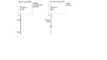

I am having problems with my 1996 plymouth neon. The gas, temperature, and gas needle is not working. The car runs fine but I have no idea how fast im going, how hot or cold it is, and if I have gas or not? I checked the fuse box but all the fuses seem fine.

I'd use a voltage tester on the applicable fuses to see if there is voltage. Also, could be problem with cluster itself.
https://www.2carpros.com/forum/automotive_pictures/170934_neon_fuses_1.jpg
