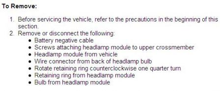

how to change a headlight bulb drivers side

Hello, I came across this, not sure if it will help much?
https://images.2carpros.com/forum/automotive_pictures/170934_headlamp_1.jpg
