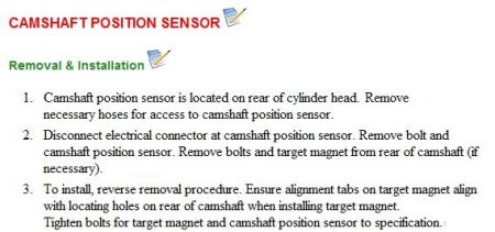

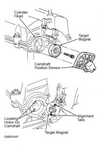

where and how do i replace the cam sensor? I bought the part just have no idea where its located or how i replace it.
