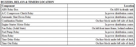

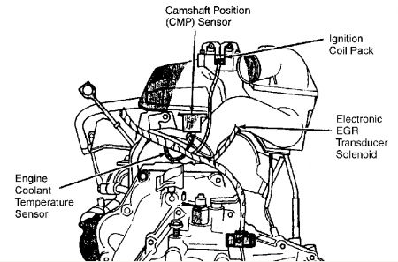

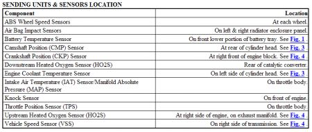

1997 Plymouth Neon You didn't give me information I request
1997 PLYMOUTH NEON
128,000 MILES • 4 CYL • FWD • AUTOMATIC
WARD HEWITT
I need to know the location of the water temp and fan sending switches on the 2.0 6 ohv engine. PLEASE

Neon 1. Turn ignition on. Using scan tool, actuate radiator fan relay. If fan motors do not operate, go to step 3). If fan motors operate, condition required to set DTC is not present. Check wire harnesses and connectors for broken, bent, pushed out or corroded terminals. Repair as necessary and recheck system. If wire harnesses and connectors are okay, go to next step. 2. Continue using scan tool to activate motors. Wiggle harness and connectors between PCM harness connector and fan motor connector. If fan motor operation is not interrupted during wiggle check, inspect related harnesses. Check for chafed, pierced, or partially broken wires. If wires are okay, test is complete. If fan motor operation is interrupted, repair fault where wiggling caused interruption. 3. Continue using scan tool to activate fan motors. Using DVOM, backprobe fan relay connector terminal No. 2 (Dark Green wire). Fan relay is located on left front inner fender frame. If voltage does not cycle from zero to battery voltage, stop scan tool fan motor activation and go to next step. If voltage cycles from zero to battery voltage, check wire harness between fan relay and fan motors. If harness is okay, repair or replace fan motors. 4. Turn ignition off. Disconnect fan relay 4-pin connector. Turn ignition on. Check voltage at radiator fan relay connector terminal No. 4 (Gray wire). If voltage reading is 10 volts or greater, go to next step. If voltage reading is less than 10 volts, repair open in Gray wire or fuse No. 5 (30- amp). Recheck system. 5. Turn ignition off. Check resistance at fan relay connector terminal No. 1 (Black wire). If resistance is less than 5 ohms, go to next step. If resistance is 5 ohms or greater, repair open in Black wire between fan relay connector and ground connection. 6. Ensure ignition is off. Disconnect PCM 40-pin harness connector. Check resistance at PCM 40- pin harness connector terminal No. 18 (Light Green wire). See Fig. 8 . If resistance is 5 ohms or greater, go to next step. If resistance is less than 5 ohms, repair short to ground in Light Green wire. 7. Check resistance in Light Green wire between PCM 40-pin harness connector terminal No. 18 and fan relay 4-pin connector terminal No. 3. If resistance is less than 5 ohms, go to next step. If resistance is 5 ohms or greater, repair open in Light Green wire. 8. Connect fan relay 4-pin connector. Connect a jumper wire to PCM 40-pin harness connector terminal No. 18 (Light Green wire). Momentarily ground jumper wire. If fan motors operate, replace PCM and recheck system. If fan motors do not operate, replace fan relay and recheck system.
